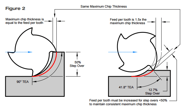

What is chip thinning?
Earlier we talked about Feed per Tooth, which controls the thickness of the chip and how much material each flute engages. In reality, this number is only technically correct when the tool is cutting at or above 50% of its cutting diameter – which is pretty uncommon. As you can see the image below, each chip is widest at the lagging edge of the flute (entering the cut) and gradually thins until it is cut off at the leading side (as the flute exits the cut).
Courtesy of Harvey Tool - visit harveyperformance.com
Why does this matter? When you start cutting with less than 50% of the tool’s diameter as one usually does, the actual FPT is less than the programmed FPT. In most applications this is nothing to worry about as we take a large enough radial depth of cut that the tool is not being damaged. When taking increasingly small cuts with a small FPT and increasingly large tools, issues start popping up. A half inch tool taking a .001” finishing pass at a programmed FPT of .005” results in an actual FPT of only 0.0004” – and before you ask, no, the extra zero isn’t a typo. As you can see checking the chip thinning FPT with the programmed value can be critical to tool life and preventing rubbing when taking small passes.
