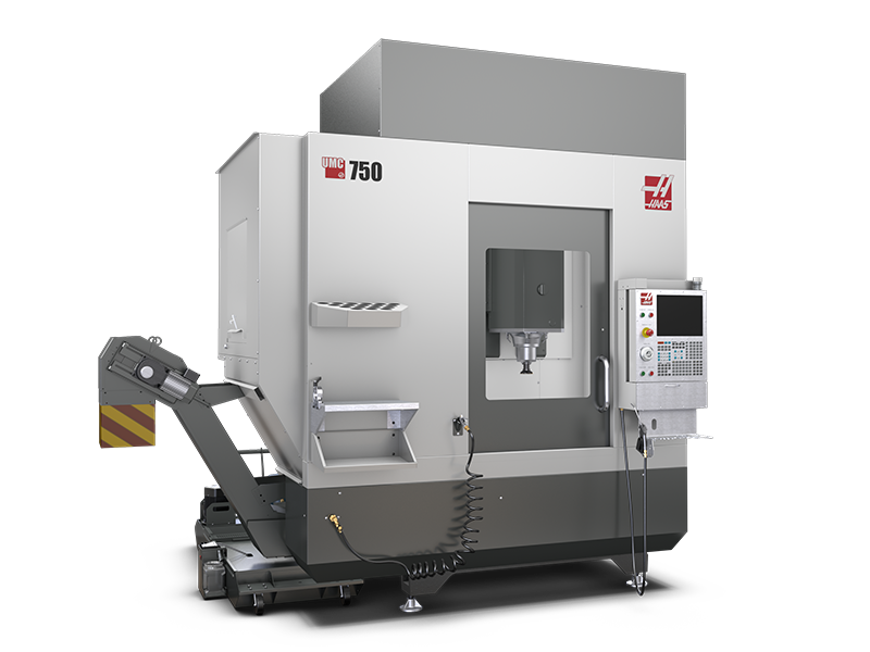

For our first dedicated 5-axis mill, we went with the Haas UMC-750. It is an extremely flexible and capable 5-axis machine with the travels, rigidity, and horsepower to handle nearly all machining needs.
Machine Specifications:
- Travels (XYZ): 30″ x 20″ x 20″
- Spindle RPM (base): 8100
- Max Power Rating (base): 30 HP
- Spindle Taper: CT or BT 40
- B Axis Travel: 110° to -35°
- C Axis Rotation: 360°
- Tool Changer: 40+1 Side Mount
- Coolant Capacity: 75 gallon
